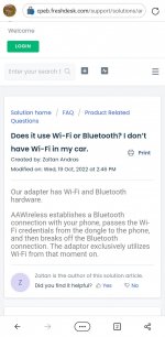

The UI is available over the app: AAWireless for Android Auto™ - Apps on Google Play
Ah OK, thanks. I did download that but I missed the only useful screen, the device settings one. Not that there is much in there...
