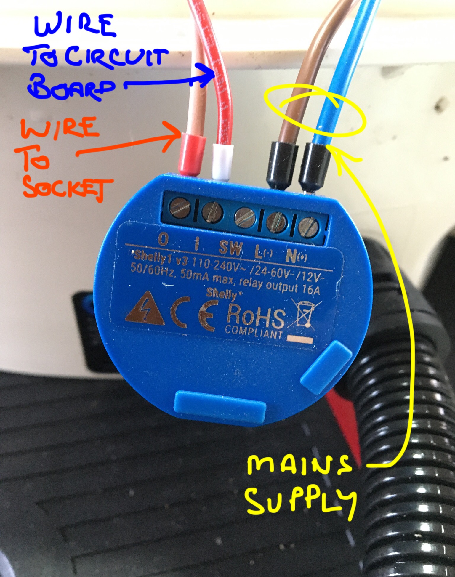

However as this is a socketed box it is far easier to connect the shelly L1
to the terminal on the back of the socket- clearly marked CP
For the purposes of this project, 4 connections are needed to the Shelly L1
Mains L & N
I & O to the red pilot line. All the Shelly does is act as a breaker in the red pilot line.
The mains supply was taken from the terminals on the live feed side-
there is just enough room to get the wires in.
The red pilot line was taken from the back of the type 2 socket and put into the Shelly L1.
A new short lead was made up to connect the pilot line from the shelly back to the socket.
All connections made, I stuck the Shelly to the inside face of the box with a 3M sticky pad
and closed the box up, making sure the cables were all tucked in and the box seal in place.
Putting the box back on the wall was straightforward and the whole job only
took an hour including taking the photos, so not bad.

The Shelly device is only switching the low voltage pilot signal, the unit you have on order appears to switching the higher load itself.
These tend to be a lot more expensive than the Shelly devices.
Also, chopping the mains voltage isn't a great idea when the input to the EV's on-board charger is a largish inductor. Inductors don't like to change their current abruptly, like from full power to zero; they react by generating a large electric potential that can harm sensitive electronics and pit the relay contacts.
By switching the control pilot, you signal to the on-board charger that it should ramp down power quickly (but nowhere near as quickly as disconnecting the power via relay contacts). It can do this safely.

I'm very impressed with the Shelly L1, for around £10 I've got a "smart" charger. I'll be getting
more of these gadgets to do some more automation around the house.
Hope some of you find this information useful. If you're handy and feel like having a go, I'd
say its worth a try.
As I said my unit was out of warranty so nothing really to lose. I did enquire with BP Chargemaster
about upgrading the unit to one of their new smart chargers- They wanted to charge me over £600,
even though the wiring was all done!
If the Shelly hadn't worked I was considering having the junction box swapped out for a
commando socket and getting one of the Ohme boxes with the Octopus discount offer, but I'll
keep my pennies in my pocket for now!
