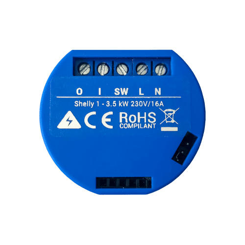

Hi can anyone point me to a link for the correct Shelly that will work for this mod please?
The Shelly1 Wi-Fi relay that I was using on my dumb Rolec to charge our previous Gen1 ZS EV looks like this.
But I think this unit has been replaced / updated now and is a different shape.
There appears to be an extra terminal connection on the newer model ?.
If you are following the instructions previously outlined in this thread, then the older original Shelly unit maybe the way to go !.
Finding one “in stock” was a bit of a struggle, but here you go 👍.

Thank you. That’s amazing you managed to find the same one from the original post in stock as when I was looking they were all out of stock. I appreciate your effort in finding it. I shall order one and follow the instruction and hopefully save me having to spend a lot more money buying a new charger.
You are very welcome !.
It did take a bit of finding 😅.

Tempted to have a go at this, but looking at the Shelly, I notice it says max 16amp. My chargemaster is 32amp - is that an issue? Were the rolec or chargemaster chargers 16 or 32amp
Appreciate any advice!
This did confuse me a bit at first, but then I actual fact, after some time thinking about it, I realised that the 16 amps that the Shelly can safely switch, is MORE than enough.
Why - Because you are not switching the mains supply feed to the car, you are only interrupting the control wire, which is very low voltage and current.
I believe you can buy a timer relay that will switch the main supply, but they are very expensive when I last checked.
I tried both a Shelly device and a Sonoff Wi-Fi switching relay ( they work in a very similar way, but I found the Sonoff unit a bit of a pain getting it to pair TBH ) the relay work absolutely fine in our older dumb Rolec and it worked with out any problems over the two year plus we had our ZS EV Gen1.
We now have the Gen2 LR model, which has the delay feature already built into the car from the factory, therefore I have just left the Shelly inside the case, but just disconnected the signal wire.
So I can still control it from the app on my phone and hear it clicking ON and OFF.

Thanks. So the 16V refers to the switching current rather than the input power. It does say that on the Shelly box.
So as to not mess around with the main power input (which is a thick wire) I was thinking of taking power to the Shelly from the highlighted section below (which presumbly is powering the display on the charger). Cutting the cable and connecting the shelly via a 3-way WAGO.
Can someone who knows what they are talking about let me know if that is a sensible idea please(!)?
The 16A (A for amps, not V for volts) refers to the maximum safe switching current for the Shelly, yes.
So as to not mess around with the main power input (which is a thick wire) I was thinking of taking power to the Shelly from the highlighted section below (which presumably is powering the display on the charger). Cutting the cable and connecting the shelly via a 3-way WAGO.
That seems like a good way to power the Shelly. But it's not totally obvious to me that the Shelly can switch anything other than mains. Hopefully the 0 and 1 terminals are isolated, so this would be ok for switching the control pilot signal.
Though ideally I think you'd possibly want a changeover contact, with +12V on the Normally Open side, rather than merely open circuiting the control pilot. That's what I did on my EVSE, though I can't remember the reasoning.
