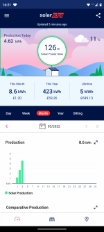

I have a 4.75kw solar edge system with a Tesla powerwall. It's proving very good, installed late 2019. 2020 was my first full year and wasn't considered a very good year for solar generation but it still made a big dent in my power bills.
Make sure you choose a good installer, not just someone offering a cheap deal as it's a long term investment.
