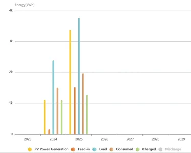

We've had a crap year, mainly due to house supply often over 253V, which the DNO have finally re-tapped the transformer, so now only 244V!
On balance, the leccy bill for our house was £459 and we fed in £267, but factoring in our massively reduced petrol costs, I'll take it as a win!
