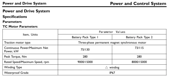

Turns out the motors are different between SR (Type 1) & LR (Type 2), interesting though, that the higher spec seems more efficient?

I don't think it's more efficient, a bit more powerful certainly. Maybe the extra power isn't enough to offest the extra weight? Either way I can only go by personal experience.
… a bit more powerful certainly. Maybe the extra power isn't enough to offest the extra weight? Either way I can only go by personal experience.
That’s the odd thing, the LR’s motor is less powerful (on paper) despite the car being 40lbs heavier?
