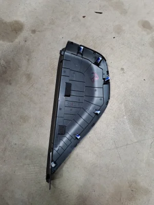

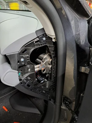

Fuse changed, 12v socket... Was not easy to reach, required the removal of a relay to get access to the fuse.
Driver side knee panel is on dash end, not under the steering or anything else. Pull it away at the door seal at the bottom, that gives you a finger in to prise the panel out towards the open door, work around the front of the dash to the top, the knee panel then folds away free of the seal.
Reverse to put back on. Top, front then work downwards, push fits. Install over the seal, but when panel is seated be sure to prise seal out and reset it over the panel again!
Some photos to help people who might be looking for this in the future.
