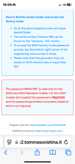

The password generator site had this sentence:
"The password ##4479#* is only valid for the 2022 and 2023 Standard models. For the 2024 models (all models), the password is !Mg12345 and the time-based password generation procedure is not required."
Don't know if it works but you can always try.

Hi I have been able to get to engineering mode on right hand side screen with the following PIN number !Mg12345
As outlined in other threads tap 4 times
on entertainment screen sub menu.
(I found a note online see pic below that shows cars from 2024 onwards no need for VIN and date combo info to be entered into PIN number generatator)
