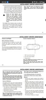

Just looked again the front bumper cam is for 360° parking cams. The one top of windscreen is the radar for driver aids hence if gets snow rain excessive sunlight you get the warnings
Interesting...
It's clearly a peculiar coincidence that wiping the camera lense on the front bumper seems to solve the problem for me.
I wonder if it's the windscreen mounted camera used for lane assist, whether there is also some input from the front mounted camera.
Or by pure coincidence, the action of getting out the car, usually with the drivers door open, cleaning the bumper camera coincides with the windscreen camera clearing.
