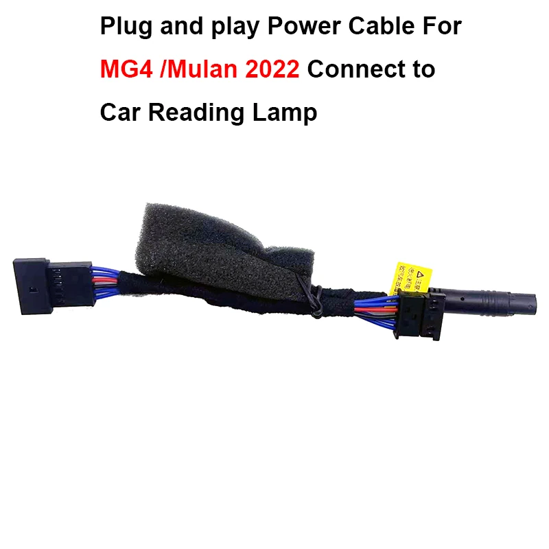

Just fitted a dash cam to my LR MG4. Bought a power adapter cable from China (not sure if I can post link ?) and a 12v to 5v from Amazon. The power adapter cable comes with a round small 8pin which I cut off to reveal 2 wires (red/black) connected to 12v to 5v and checked power to dashcam. Boom, works a treat.
A few photos attached to show connection.
Dashcam will auto switch on when car opened and switches off when locked.
