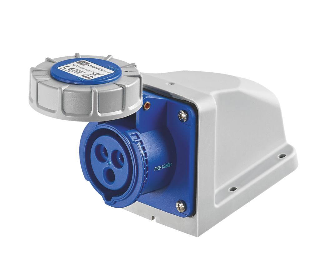

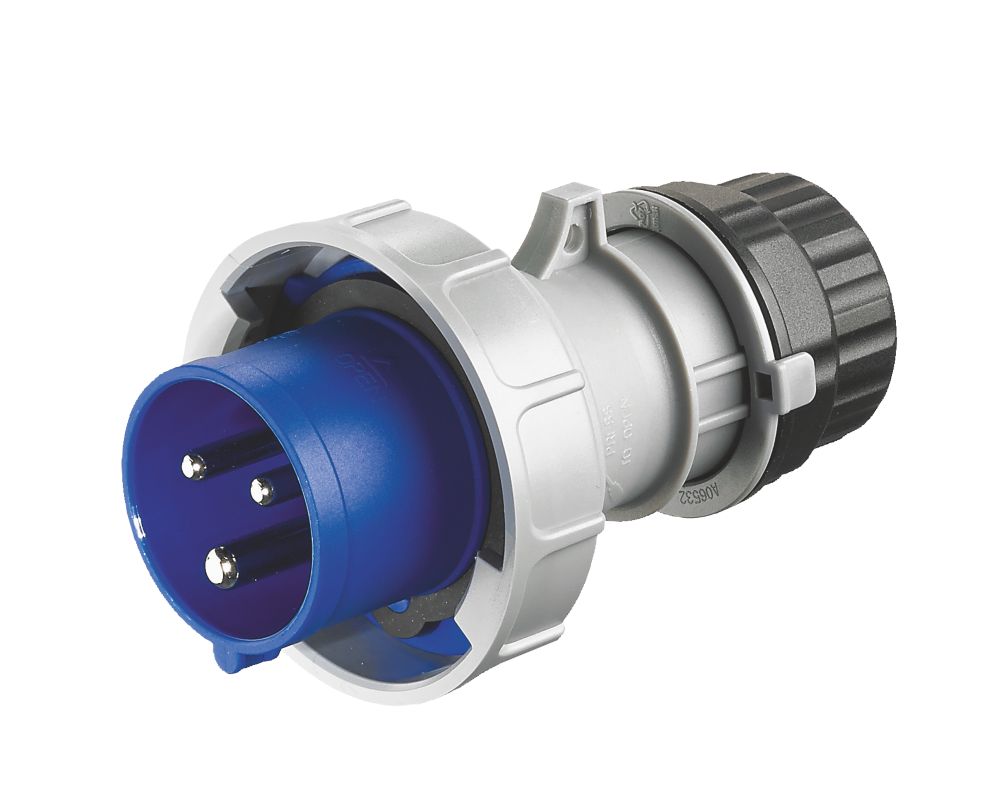

Basically replaced the standard 3 pin plug with these.:
Better environmental protection that the standard weatherproof socket boxes.
Edit - the other point of course being that I put a much longer cable on it.
