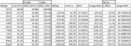

Hi I have been driving my MG PHEV duing the winter and a bit frustrated with the Engine requiremnt for the heater cutting off the EV completely. Our Kia Niro uses the battery for traction and seems to idle the engine to provide heat. Does amazing MPG. I have been keeping a log of petrol use over the winter. I switch the car over to EV as soon as I think the demands of the heating are met. This is usually after 2 miles or so. My impression is that I am doing a lot of EV miles. I have logged the car for 2766 miles and I calculate overall 41.8mpg , the display on the car has logged 3650 miles and is showing 43mpg. This is NOT very good. The fuel guage shows miles available in petrol terms and I have tried to log this as well so miles used acording to the guage taken away from miles on the car might aproximate to EV miles. This would make the petrol engine alone at 32mpg which is dismal. The PHEV despite my efforts is doing no better than a normal MG-HS. This maybe that during the winter I am nonly running the engine until it warms up which is not going to be efficient. Perhaps when using the heater is is better to run the engine up to temp and let the battery run STOP/START. Hoping for better in the summer.
AND ALSO - if the car had an electrically heated fron screen for de-misting I would probably sit in the cold and run EV during the winters short journeys.
