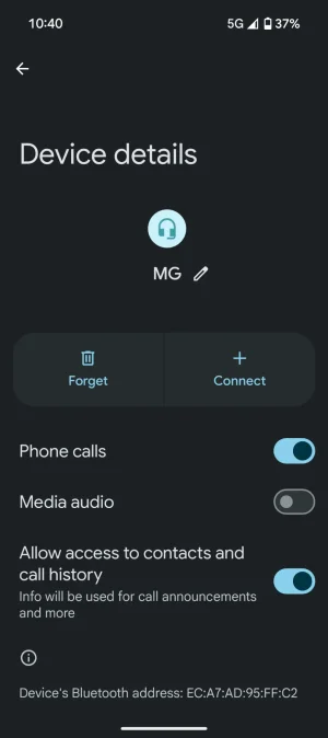

I have a Pixel 9a and what helped me with audio stuttering was disabling multimedia audio in the MG bluetooth settings in the phone, somehow this conflicts with the wifi connection for android auto.
But the wired connection is always more stable.
I looked at the BT settings on my Samsung, specifically the ones for the car, but i dont have this there. I can set "Calls", "Sound" and contacts but these are all on/off settings. I can also define the type of sound device to "headphones", "speaker" or "Other" and its already set to other. I think this adjust max volume or EQ.. not sure..
Media audio In the MG bt connection, in your case it should be sound?
Yeah i think so. I notice that i didnt actually say what they were set to, but only contacts is enabled. Sound and calls are disabled.
Thanks @pmca that worked for my audio. Been in the car twice since turning media off in my settings and the audio has been perfect. Just now the phone calls they can't hear me at all, tried turning phone calls off as well, see if they would go through wifi but it turned it back on automatically.
