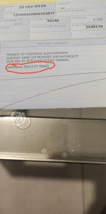

Honestly, I’ve looked at just about every review/posting, since taking delivery of mine. I’m a bit sad like that. It was included in one, but I can’t remember which.
When I have a moment, I’ll have a search.
Thank you, no worries. I was just curious to see if you had any additional insights directly from MG.
