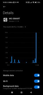

Another strange thing is, the iSmart App showed high data stream.
