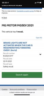

Thanks for the response, my car was delivered early December as well. Don’t know what the limits are on speed, but Government website gives the information attached, this is accelerating de acceleration figure, do not know what this relates to in MPh, I hope some boffin on the forum might know.

The light should come on at any speed if the deceleration is greater than 1.3m/s2. I.e the quicker you slow down the more likely the light would come on (subject to it working that is).
