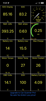

Hi everyone! Thanks for all your support which I much appreciate. Panic is over. I’ve used OBD and SOH is 100% … what a relief. I must look for different service as one I’ve used seems to be not good. I clearly asked for it and they said nothing to worry. Also when asked for 3 bottom lines of rear window heating they said its takes longer to heat while I found here it’s actually not a heater at all ?. Once again thank you all!!! Attached photos of service paperwork from service and readings from OBD
