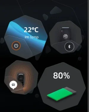

My wife has the MGS5, when she starts remote cooling in the app the fans start but never becomes cold?
A/C is fine when driving, so I'm assuming a setting or software bug.

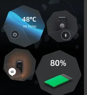

Edit: New info, tested it myself, the blowers are on and the air hot, HVAC screen is disabled but becomes enabled if you sit down and then the A/C blows cold.
Air temp according to the app is 22°C, but according my skin is more like 40°C.
Edit 2: Fiddled about, and we now have air temp 48°C and the moment the A/C is turned on in the app it records 22°C.

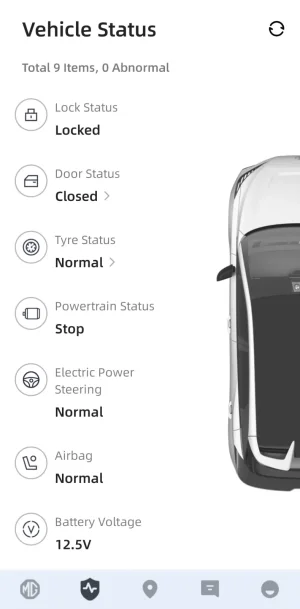

My pleasure, in this weather that is a necessity. Now all I need to do is try and find where it reports the voltage of the 12V battery, I got a message today about it being low.

My pleasure, in this weather that is a necessity. Now all I need to do is try and find where it reports the voltage of the 12v battery, I got a message today about it being low.
It sure is, hopped in mine Friday and I swear if I'd leant back in seat it would time for a trip to A&E.
I get the 12V from the app on the MG4, likely also there for you?

Nope not available on the MGS5, I wish it was, it only has lock, tyre pressure, door status and interior temp that always seems to be wrong 😁 can’t see it on any of the screens/menus in the car.
Manual says it should be on one menu/card but I guess the software changes quicker than the manual.

Ive also seen a pattern where it reports 22°C internal temperature before it updates, so i think that's the default value (if it is then it's really silly.. ) And it doesnt update until about 30-60s has gone since i sent the command. I don't really know how often it updates after that.
For the 12V battery status, if u are still looking for where it shows, it is under Status when you press the car icon on the touchscreen
