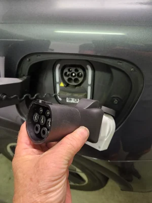

I've tried to buy a CCS2 AC and DC plug, they are either insanely priced, or the order is almost immediately refunded because they were scamming and the agency (like Temu) caught them or realised they actually couldn't get one to resell .....
Whether it is possible to scan a CCS 2 DC fast charger plug and have it 3D printed, possible I guess, but you need to get hold of one first to dismantle it .....

There is no DC to DC plugs available for the CCS2 system as far as I know, all the V2L plugs I've seen are the top AC section.
If you find or know of a CCS2 plug with the DC section as well, please let us know on this forum and preferably in this thread .....
