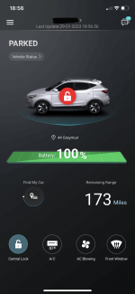

Today on 100% charge it’s 173miles on the app and 163miles on the dashboard ??
Do you think there is any chance ive been given a standard range instead of a long range or faulty battery? I know it’s cold but this is a 100mile drop in battery range than the advertised range for a LR. All paper work and registration say long range..but don’t know what to think.

Try resetting the trip counters as they are used to calculate The GOM.
Charge up overnight and let the battery balance then try it in the morning but turn off fan and AC etc.
Are you sure it is the LR ? I charged mine today to 100% and I had 284 miles on the gom. I've done a 100 mile trip and I still have 194 left on the gom.

Forget predicted range what is the actual mileage you get? 163 miles would be about 2.4 miles per kWh which if you're doing lots of short trips in the cold and don't drive particularly efficiently would be about right.

Sounds like you are doing lots of shorter trips, each heating the car up from cold. The heater uses a disproportionate amount of battery on short journeys. Once the car is up to temperature on a longer trip the average efficiency goes up. The range estimate just reflects your previous usage.

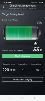

Tap on the battery bar in the App. You should get a screen like this which tells you the battery status. And if you had the LR
I had exactly the same issue but somebody on here said reset the trip meter after charging and hey presto every time I do I get the correct mileage
You get the default mileage, not an accurate prediction based on your previous driving and weather. :)
