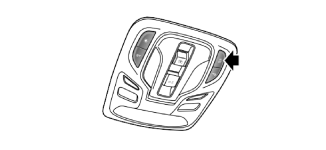

Check also the switch of the interior lights if it is off.
Regards
