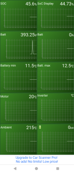

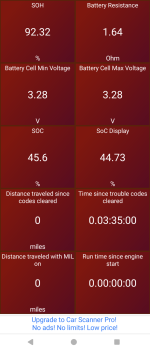

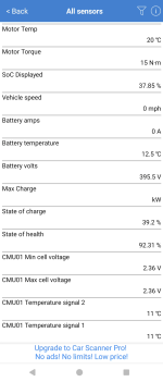

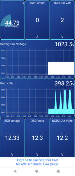

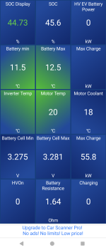

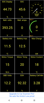

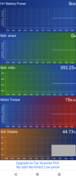

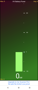

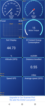

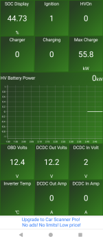

This is what I got from Car Scanner yesterday, means absolutely nothing to me so if you guys can figure out how the previous lease-guy cared about the car, thumbs up ??
I have no idea what I'm looking at ?‍?

LFP... which is supposed to degrade less than nmc. Bad luck.
In car scanner, if you go to view all sensors and scrolling down through a lot of nonsense you should see the voltage of each and every cell reported... if that is of any interest to you!
You could try letting it get down to very low battery warning and then fully charging. And doing it a couple of times. It might help the bms re-learn the capacity remaining in case it has been confused by never getting near empty. Obviously you want to be doing it very near home!

? scaring me with "LFP... which is supposed to degrade less than nmc. Bad luck" ?
I'll check all sensors screen to see if I can figure it out and I'll try that 10%-100% charge too.
EDIT: funny bit first - SoH dropped from yesterday's 93.32% to 93.31% today !!!!

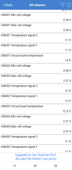

All the cells report 2.37V min and max voltage apart from CMU01 that is 2.36V for min and max voltage and CMU02 with 2.36V min and 2.37V max voltage.
Upvote 0
All the cells report 2.37V min and max voltage apart from CMU01 that is 2.36V for min and max voltage...
That can't be right. I see all the cells at 3.28V. Where is this coming from? 2.36V is disastrously low for an LFP cell.
Upvote 0
Yeah, don't worry about that. Clearly the same problem as on the 70kWh the software is not correctly interpreting the data. Maybe we should tell Car Scanner about that. It would be interesting to know how many cells there ,are though... 120 I figure. Which gives you 430V fully charged and explains the higher power output of the lfp version, something for you to be happy about :)
Upvote 0
I don't know anything about anything battery related, this is from Car Scanner yesterday, is that what I'm supposed to look at for individual cells? App dashboard shows 3.28v min

Yep, it doesn't work!
I just had a look using Car Scanner with both my cheapo 1.99€ AliExpress unit and my LELink 45€ unit. And I get exactly the same gobbledygook you do on both adaptors. The individual cells values are useless, as are a lot of the rest... and of course that makes you wonder abput the values that seem plausible, they may be correct, or it may just be coincidence.
I also tried a sideloaded version of eZS and that doesn't seem to work with the expensive BLE dongle at all. It sticks on 10-20% loading when using the cheapo one.
Guess we're just supposed to drive them, not fiddle with them ?
