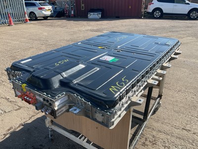

That's an expensive one!! I bought one 2m ago for £1k Try this one https://www.ebay.co.uk/itm/365637510540 Yes, I know that's just a 52.5 But you can get 61.1 for less than that.
