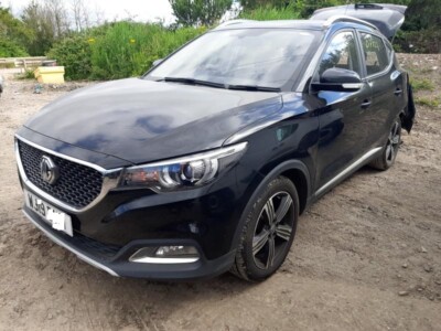

I need to replace the driver's side rear door on a ZS EV Exclusive (2020). I was thinking of getting a 2nd hand one from eBay or some such. Thinking of the electrics - would the door need to be from a car with exact same spec ( ie an electric Exclusive) or could it come from any ZS ? Thanks in advance guys.

Thank you all for the reply, I have now spoken to dealer and I'm looking at about £2000 with new door, sprayed amd fitted. Unfortunately, I have not be lucky enough to find a replacement door in the correct colour.
