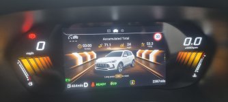

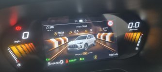

Bizarrely I drove around today. First 50 mins AC off. Got to where i was going. 51mpg including all speeds and some motorway. Warmer afternoon decided to hit it on way back, had AC and Heating on . A few stops and traffic jams not many and I couldn't believe that the car behaved so well. But it had warmed up. The day had warmed up. So I had a cuppa at home then decided to gun it up our low gradient hill area and back on all systems on. I couldn't even empty the battery so on the way home I hit a steep hill for fun and yes got the battery down a bit and heard the accompanying rev orchestra but it took me up and home again. Bizarre it has also broken its first 2,300mls which I think also makes a difference. And it was on Eco. However read my other posts from Australia we are not alone.
