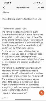

I’m glad this thread has been added to because I’ve yet to hear any admission to what is a recognised flaw by just about every driver. Is there any admitted official recognition from anyone in the channel about this please?
I can describe my experience: I wrote a formal complaint to the MG Italia headquarters and they replied that the behavior is to be considered normal; the manager simply suggested to me, if the phenomenon bothers me, to use the car in mixed mode (Hybrid mode). An unacceptable answer, also because I bought this car precisely because it can travel in pure electric mode, otherwise I could have chosen any of the countless other models on the market.
Following this ridiculous answer, I am prepared to file a legal action for non-conformity of the product. In order to prepare this action, I had the car tested on the roller bench. This test confirmed the very serious defect.
Now I still have to decide whether to continue because I know that these procedures in Italy are very slow and expensive and I am not sure of getting a good result.
I add that I recently took the car to service and they updated the software; I hoped that there was also an update for the part relating to the gearbox, but unfortunately this was not the case.
It seems incredible to me that MG could have released a car with such a noticeable defect. And I am surprised that (at least in my country) no one complains about this. Unfortunately, when I took the test drive before the purchase, I did not have the opportunity to push the car beyond 80 km / h, otherwise I would have noticed and would not have bought it.
A real disappointment, also because, apart from this anomalous behavior, the EHS is very pleasant to drive.

I confirm the hesitation occurs only in EV mode. In two case: 80 km/h and 125 km/h.
Indeed I verified 3rd (known) and 4th gear (first for me) today. Heck regen was so strong that the car exited EV mode
I have also found this issue, but also when in auto the car jumps around as though the engine is cold! Also a couple of times whilst in EV mode taking off onto roundabout it did nothing for about 1-2. Secs! Very scary when you are trying to get between traffic! I will be arranging a visit at some point to dealer as I am not convinced that the Accelerator sensor is working as well as it should (or maybe is does not have enough pulses from the encoder).

I was toying with the idea of reporting to this and saying if you are joining a main road etc and it changes, let's say your going up a hill the car would slow drastically and could be considered dangerous but didn't know if they would agree etc here is the link
Vehicle recalls and faults
That would be a good idea but would need all of us reporting to then. I would like to know how many on the forum have any answers from MG Uk
