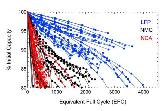

Also, as mentioned earlier, battery life is to be considered if the car is yours and not a rental (Lease, PCP).
For same annual distance driven:
Smaller battery = more charge cycles
More charge cycles = shorter life.
But LFP batteries have a longer lifespan / cycle life.
Also, with LFP batteries you could use 100% battery capacity, because you don't need to keep the SOC between 20%-80%.
