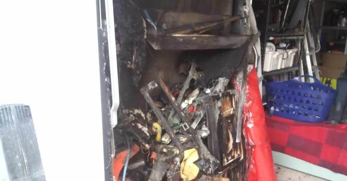

This is rather alarming news
Until you confirm it was the charge point that caught fire, and the reason for the fire, you have to trust whoever installed your charger to have done it properly...
A single fire is not a trend... and I don't see everyday reports of chargers causing fires.
The Daily Mail might like to use the report to spread their anti-EV mantra, but the rest of us would treat this as an isolated incident and await any investigation report results...
The most common electrical fault resulting in fire is going to be a loose connection causing arcing. A point in favour of using an AFDD.
And short circuits from failed components. An appliance is only as good as its weakest part (which hopefully is the fuse). :)
