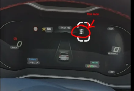

What is this dash icon please.

Can any one please tell me what this icon is. Also is there any doc that tells what all the dash icons mean.

I'm not sure but I think it is a representation of the adaptive cruise control distance from the car in front. 3 bars is max distance &1 bar is min. It is referenced in the adaptive cruise control section of the online manual, but I can't see a picture of the icon.
Yes the ACC distance. Turn the collar on the cruise control stalk and it reduces to eventually 1 bar = shortest distance to brake with an obstacle in front of you
That is correct. You can alter it when you are in cruise control. Pull lever under the indicator once to set Cc. Press end of stalk to set speed. Then rotate 1/4 turn either direction to set the distance to the car in front. If you pull the stalk again LKA will be activated. This I do not recommend.
