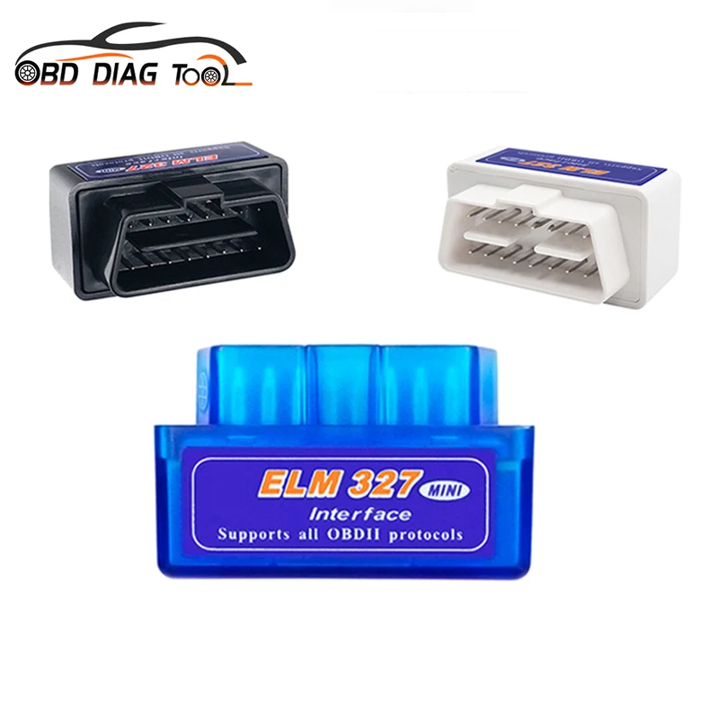

I have the blue one like in your AliExpress page that I paid about £3 or so - works well with "Car Scanner" app but not really with "eZS" app - keeps getting stuck on connection to the app, only two or three times managed to get into eZS app.
Try them all until you find the best app and dongle combination ...
I have that blue one as well, eZS will sometimes say "Connected" but it seems to get stuck at 33% when trying to read out anything.
Worked perfectly with car scanner on multiple cars i have owned previously

I have cheap £3 blue ODB2 dongle from AliExpress, like the one posted above, it works perfectly well with free version of Car Scanner and it shows SoH and loads of other details that I don't even know what to do with ...
