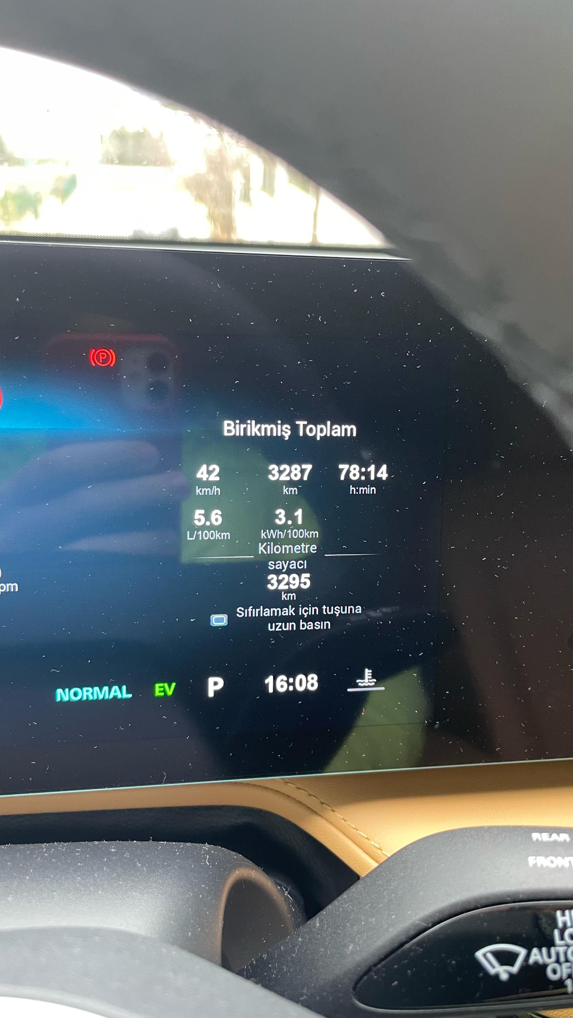

I have a hs phev. It's currently 3,300 km. My fuel consumption is as seen in the picture. 75% long distance and high performance use. I charge it once a week at home. Even if I run the heater at the highest or lowest temperature, the gasoline engine doesn't start. I think there is a heat pump in the car, but it's very inefficient and consumes the battery too much. The gasoline engine starts when it exceeds 120 km/h. The gasoline engine starts during sudden acceleration (if you press the gas pedal all the way). If you pay attention, you can see a consumption of 5.0/lt.
