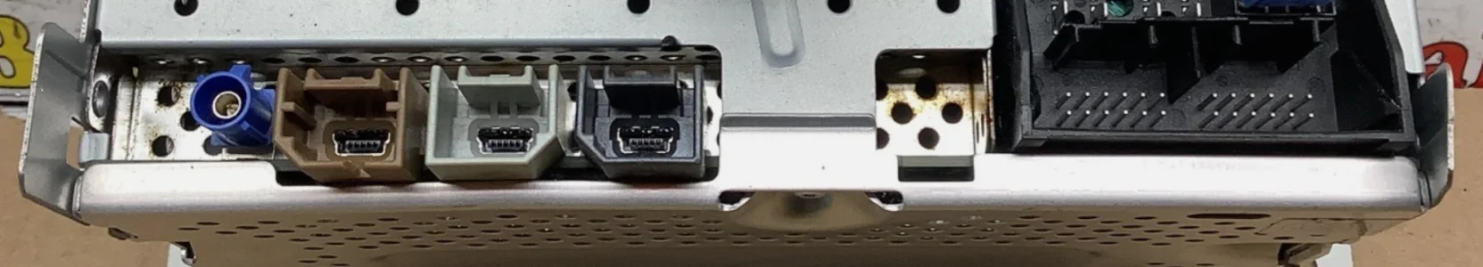

2022 MG5 infotainment unit connectors.
Some of these units with the same part number don't have the white Fakra connector. The white one is known as 'Radio with Phantom Supply'.
I only have the blue connector. Any idea why there are two versions?
Mine won't boot up anymore and only the reverse camera is functioning.
Ta.

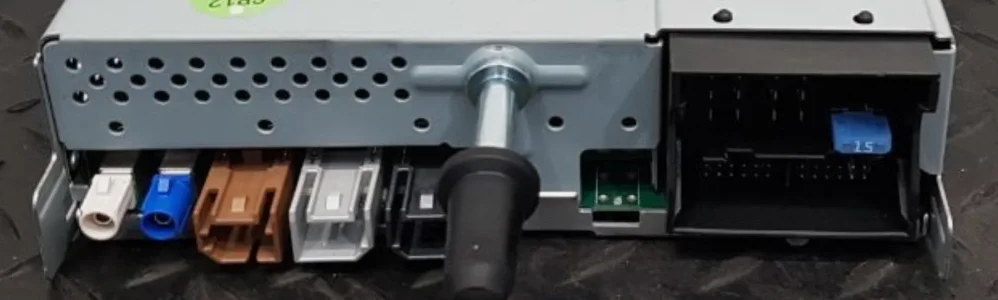

UPDATE
Having bought the unit with both connectors as the serial number showed it was a newer unit, I now see that the ones with the white connector do not have on-board DAB and now neither DAB, FM or AM work.
Good job I listen to streamed music all the time!
