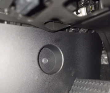

If you remove one of the centre kick panels, I used the drivers side for my example, but if you do the passenger side, you won't have to remove the footrest.
One popper clip, then 3 clips attaching it to the centre console, they just pull out.

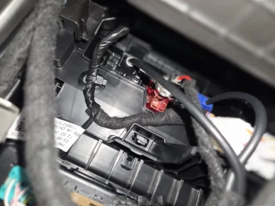

This gives you access to all the gubbins behind the centre console (footrest and panel removed).
From here you can reach your hand in behind the USBs, and with any luck if nothing is broken, you might be able to clip yours back into position, it's the blue plug in this picture.
But if something is broken, which is probably the case, get one of these flanged extensions, you'll need to enlarge the existing USB hole to 29mm x 26mm, then just clip the extension into the console, and plug the extension cable into your existing USB port behind the console.
