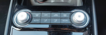

I received my MG5 a few days ago and everything worked fine.
Today when I try to use any of the air-conditioning control knobs or buttons they don't respond.
I also can't turn on the rear windows de-mister.
Anyone have any suggestions before I speak with the dealer?
i would suggest you turn everything off and back on again. Then engage ready mode. Give it plenty of time. If they’re not working then I think it’s a call to the dealer. It could be your fuse.
OK so this is weird. Checked the fuses couldn't find anything wrong.
After playing round with some settings. I changed "Auto Heated Rear Windows" from off to on and the whole panel started working again.
A bug I'm thinking...
