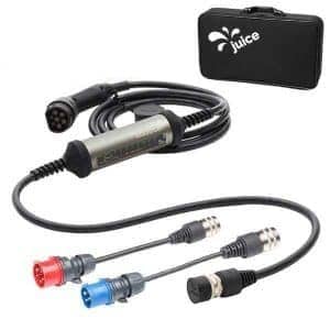

I suggest looking at getting a juice boost or similar

these are 3.5 to 21kw chargers so can do from granny up to the fastest you get without a fast charger. The one I saw at the show was around £200. I have asked if they will be at the show this month or if I can buy a couple for a discount
From £159.99. EU adapters £13.99 or £21.99 for weatherproof version. I use Tough Leads stuff and find it really good. In fact, it's tough!

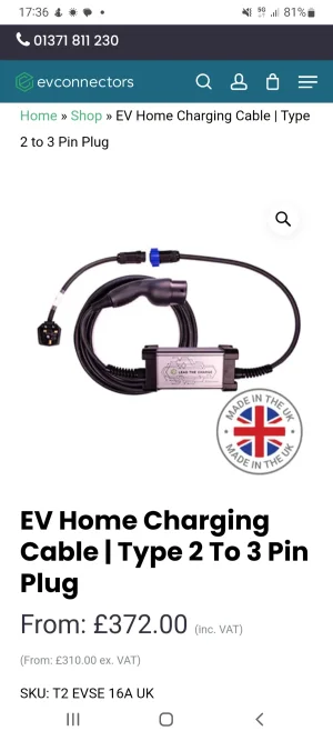

There is this product available from evconnectors.com, it comes with a 13A adaptor plug lead, but you can buy a euro adaptor cable as well for an extra £30. A bit cheaper than a juice booster but is limited to 2.3kw, whereas the juice booster is up to 22kw with the right connector.
