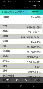

You need to check that dealer also updates the EVCC module to enable charging when unlocked (EV charger controller)
My screenshot of my EVCC and BMS versions are attached for reference

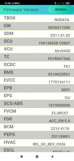

Does not seem to have latest BMS which was redesigned by MG to protect the battery performance, so it is worthwhile having the latest updated BMS 0210622EU1.
1230621A01 was 10/1/2021
0210622EU1 was 2/2021
Both allow 449/450v at full charge.

Like to know what the difference between them as only had the Jan BMS release installed on 1st Feb. Not sure what the EU1 gives.
My car is back to full range. 449v. Balances in 2 hours.
I understand the latest BMS EU1 update has the following effect.
'The new maximum voltage will be around 449/450V (assuming no loads on like climate etc). The minimum voltages have been adjusted to keep the range equal. This may also allow the car to have better regeneration from 100% charge.'
