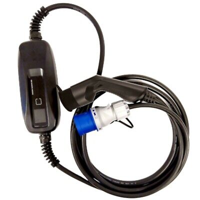

This might be a safer way of doing it👍
I wonder what that box actually does, it is quite a bit more expensive than just the cable.
This box is not ideal for me though, as it seems to be only 1 phase and the Scandinavian charger is only able to charge at 3,6 KWh on a single phase.
But if there were a box that did 3 phase charging i would be tempted to buy one.

Look up “3-phase EVSE” that’s what you need. Plenty on AliExpress and the like. A raw cable won’t do as there’s no way for the car to understand and complete the charging handshake.
Ok folks hold your horses. A Type 2 to Type 2 does more than just pass AC from one end to the other. For a start there are the CP and P wires over which the EVSE (ie your wall box) and the vehicle charger communicate over to perform safety checks and then negotiating the charge rate to offer the AC to the vehicle. Only when all the conditions are met will the EVSE (which stands for Electric Vehicle Supply Equipment) enable the supply of AC to the car.

I don't think he has an EVSE just single and three phase commando. I sent a link for EVSE with commando similar to the Ohme👍
I to have showed the right hardware to be safe BTW I don't think we are allowed to display referral codes? Also I do believe he was after 11kw I don't then ohme cater for that?
I to have showed the right hardware to be safe BTW I don't think we are aloud to display referral codes? Also I do bleave he was after 11kw I don't then ohme cater for that?
Yes I agree the hardware you showed would certainly provide single phase and possibly 3 phase although I've not seen a three phase "portable" ESVE advertised anywhere. The cable on the Green Wallbox in the picture doesn't look thick enough for three phase IMHO. I offered comment on the Ohme because I looked at getting one myself and my daughter has one which she has fixed to the wall and hard wired (rather than Commando Plug) and I therefore know something of it. Octopus Energy used to offer them at half price subsidised cost of £199 a year or so ago when I was looking at them but checking today i see that as we might expect the Hardwired Ohme EVSE has increased in price even with the Octopus subsidy. I have no vested interest in what information I have to offer wrt the Ohme and if the original question relates to a vehicle not only of Scandinavian spec but to be used in that region then perhaps the principle only if not the product in particular is relevant. However, it may be of assistance to UK owners on the forum.
