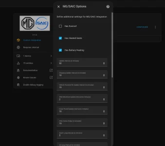

Have you noticed on your implementation of HA if when it polls the car for the information, your car headlights come on for a few seconds?
I have had to disable my implementation of the integration since my car has been illuminating the whole street each time it has been asked for data.
Are you sure it's because of the integration? I also noticed that it turns on the light for a while when loading. I also have HA running.
Hi @Totti1001, the integration was set to a 10min update - just for testing purposes, and every 10mins the headlights came on and lit up the street! So I have disabled it for now until I can find out if this action can be stopped - but I am not sure it can be.
