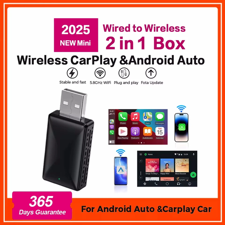

Is your wireless AA connection via built in wireless or are you using a dongle? How do you get on with patchy mobile phone coverage? I'm using a dongle in my MG5 PFL and AA disconnects the wireless connection when mobile data drops out. There's a lot of people with various phones in various cars complaining about the issue - but no apparent action from Google.
I'm using a dongle - this one linked below to be precise. (The MG4 doesn't have built-in wireless AA/CP). I've never noticed the connection drop out ... the dongle presents a wireless AP connection for the phone, and they also sync via Bluetooth LE. Mobile data (from the phone) is only used so that live data can be updated (e.g. when using Google Maps or a streaming service).
I have an Android 9 phone with Auto as an app. Also a cheapish cable. Can be a bit glitchy when connecting but once working is absolutely fine. Cannot find a dongle which supports my phone so will stick with the cable until the weakest link dies. :eek:
