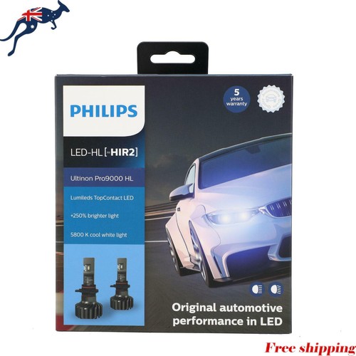

Hi Iain, I bought these as recommended on the forum;
Will let you know how they go.
Thanks dal0037, I look forward to reading your experience. I might try and find out what bulb they use in the Essence as it must be a consumable that’ll need replacing at some point. I was hoping to buy the whole headlight but was told by the sales team that it’s not compatible, I have my doubts.
I’m fairly sure that suspension height sensors are required for LED lights similarly to xenon’s. that may be why they say they’re not compatible.
They’re very good lights and money well spent. The aim is perfect. Very bright.
That's with the Philips Ultinon Pro9000's? So you can confirm they work well and worth replacing the halogen bulbs? I pickup my new HS+EV Friday so would be good to have bulbs by then.
Thanks
Correct yes, the 9000’s. worth the spend.
Perfect, thanks.
Okay, so I'm 1 step away from the purchase. I see the lifespan is 5000 hours and the AuxBeam is 50,000 hours and cheaper. But I like the thought of an established brand like Philips. I'll update how I go when I've purchased and installed. Thanks again.
