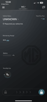

Ok so MG unbinded from previous owner but it’s still not binding. I’ll attached images from the app and car.
What else do I need to do ?

I do remember having to try several times to bind mine for some reason and I understood from some others that it wasn’t unusual to have to do that.
There are quite a few videos on binding the MG ZS EV on YouTube, in case that helps to clarify the steps.
