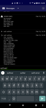

I have my service scheduled for later today and want to ensure I get the BMS update that allows for more rapid charging. I rarely ever see much more than 60 kW, and then only for a few minutes.
My MG is just over two years old, had its last service in Sept 21. During that service they did no software updates.
Can anyone advise what this version no is?
I've attached the info from OVMS this morning.
I believe that OVMS incorrectly calls the on-board charger "EVCC". I pointed this out months ago, but no-one who has power to change it seems to care.
With any app, you have to be plugged in and charging for the OBC firmware version to be displayed. Otherwise, the OBC computer is sleeping, and doesn't respond to the request for version number information. In the upper part of your screenshot, it mentions "not charging".
