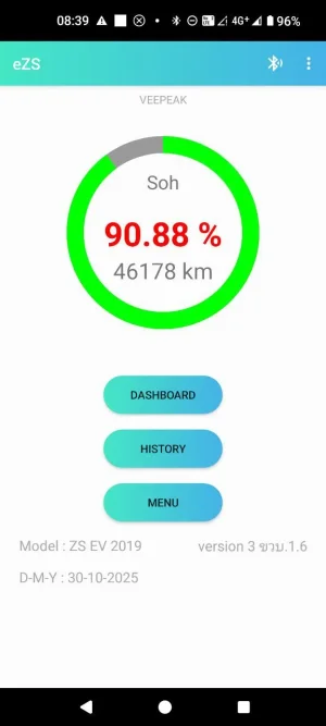

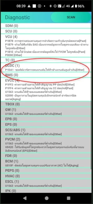

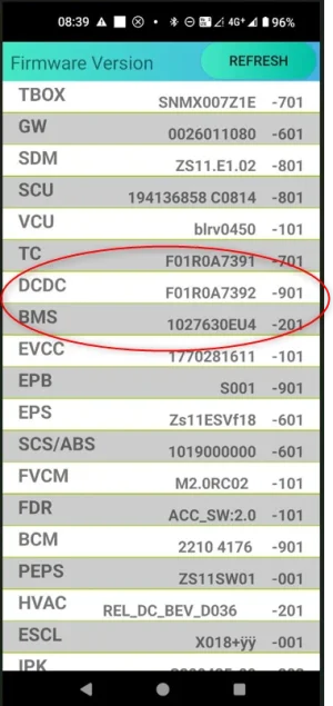

I enclose the values I was able to retrieve before giving my car to MG.

The only firmware you can check yourself is the infotainment unit. All other modules need to be plugged into the MG diagnostics at the dealership.
