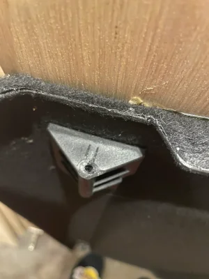

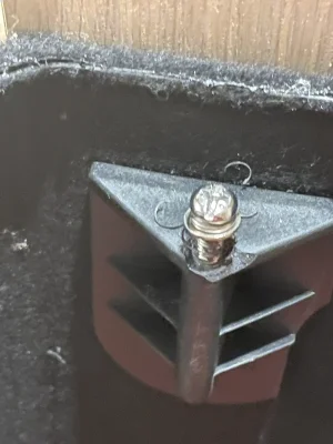

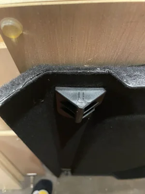

Not pointing any fingers ( :D ), but Mrs S has managed to break off one of lugs that locks in to keep the shelf hinged in place, IYKWIM.
Having looked at the cost of these, both new and second hand, they are very expensive.
Does anyone have any experience of gluing these rigid plastics and which would be the best one to use?
Or am I on a hiding to nothing?
Thanks for your help.
There are 3d printed replacements: MG ZS MG4 SAIC MARVEL parcel shelf clip by infinity2
Don't know how good this works.
I'm not sure it's fully her fault, i blame the design as almost every car i have had you lift the shelf up and pull out, however on the MG it comes out sideways.

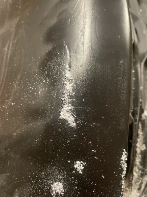

Remove the shelf and as said above, use a strong super glue to get the two parts boded together, then to add extra strength either use some hot melt glue, or you could use super glue and add some baking power before it sets, it will set like concrete 👍🤣.
