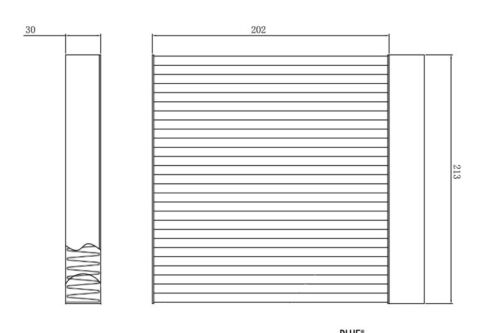

Cabin pollen filter
If you remove the one already fitted you may find some identification marks.
This looks like the OEM part number, but double check with the dealer and its price.
I would imagine over £30.00 myself.
OEM filters are about £28.00 on line and with very quick check, I found an after market filter for about £24.00.
So not a great difference in the price really.
Bit more searching required first I think ?.
Update :- Just spotted this, be quick !.
