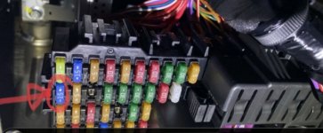

Screenshots of fuse board taken from Tom's man shed youtube video. 15amp blue fuse if you want to piggy back to fuse that comes on with car. I used that for my dashcam.
