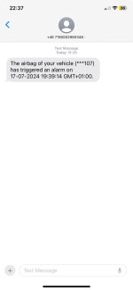

ZS has no electrics and is completely dead key fob does nothing. Thankfully it is on my driveway. Got message from app saying air bag triggered an alarm. Which may be connected. Anyone experienced this. Car is 10 months old.

I’d go straight to your dealer though to get this sorted out, as it looks dangerous to have an airbag alert when it hasn’t deployed. HTH.

I've had this airbag message just plugging in the OBDll reader.
