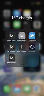

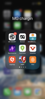

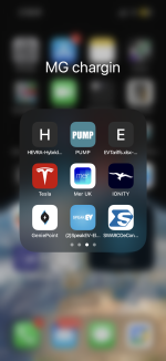

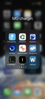

Here’s my phone screens, we have had our ZS TLR just a couple of weeks and love it !

Install every charging app you can find and register your details/card where required.
