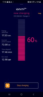

Ive managed 72kW on Ionity in my LR. That was in cold wet weather, but had just driven 170 miles.
