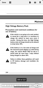

Just to add to this, there is a page in the manual for the 2022 version but should also apply to any EV really that gives advice for storing the car for long periods which everyone should take heed of:-
